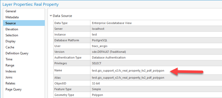

I was getting this error and realized in ArcGIS Pro 3.0 that sometimes when using a Postgres view, a query is being sourced rather than a table.  When I confirmed the table was a source, I was able to publish without any issues.
Settings when I got the error:
Settings that worked (same map)
