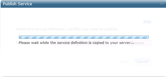

8. Saved a service definition file and then tried to publish the map service using ArcGIS Server Manager. I get the following screen for an eternity.
