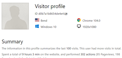

A couple months ago I put Matomo (free) on a docker instance and started adding tracker code to our apps, that does  most of what I wanted. I can track usage of any web app built with Web AppBuilder or WAB Dev Edition. I just found out I can't track StoryMaps this way which is disappointing. It's too locked down.

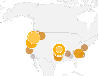

Matomo does maps too, here's a fragment of the "real time" map.
We're small fry so not much traffic here. I wish I had more sites to monitor. Maybe we could help each other.
