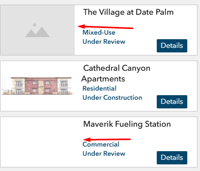

Running an Enterprise 11.2 that has a collaboration to our organizations AGOL account.

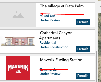

I am experiencing issues with data syncs where images are coming through as a solid white, or with the default image at random, and change while interacting with the map.. ie scrolling will load the image sometimes, but also might remove the image from an ExB List View
vs
Or a text box that is counting attributes will bounce back and forth between identifying the count vs returning "COUNT({OBJECTID})" This may change when refreshing the page.
Are interactions like this common with the Collaboration because this is almost making this technique useless for our organization as it make us look incompetent.
amarcz_cc
Keeping the original post up in case someone else comes across this.
A re-publishing of the layer that is being Synced solved the issue.
