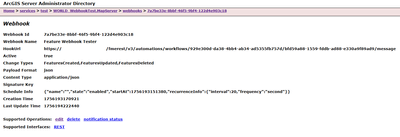

Thank you for this @JakeSkinner, so then I'm baffled why my process doesn't work. Its a simple Webhook:
Which should basically just kick of a workspace to run on FME Flow when I create, update or delete an entry in the single dataset in the FeatureService. But nothing happens on the Flow end when I do so.
However when I originally connect the Webhook to Flow then the automation there runs of without a glitch by itself (just when it is started originally and nothing after that). So it seems like the two systems are speaking well with each other and the dataset in question is in a feature set on our SDE that has Archiving, Global ID's and Editor tracking enabled.
So Im not sure what Im doing wrong here, any suggestions are very much welcomed.

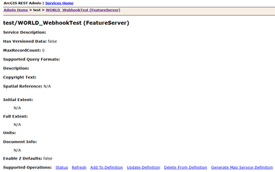

Furthermore I notice that after I log out of the admin account and log in again after a while the webhooks I have created from before have vanished.
Plus when I try the trick shown here at 11:19 (enter admin between rest and serviced in my service in question):
https://youtu.be/D9PMC2yGJbA?si=MWZMEp6vfTsMGo48&t=680
then the page I get is much more poorer than the one shown in the video:
And it is lacking the Webhook section at the bottom, regardless of if I have created one or not.
Hope this gives some insight into what I am doing wrong here...

@Hlynur - Perhaps you've already got an answer as it's been a few weeks. However, to explain:
The video you link is for ArcGIS Online Hosted Feature Services. You're using Enterprise, or more specifically, referenced feature services, served from ArcGIS Server, which technically appear as an extension to the MapService as Jake mentions, when viewing them in the ArcGIS Server Administrator. This difference is significant. You won't find webhook administrative pages here in ArcGIS Enterprise (ArcGIS Server). You need to continue managing them from the original link you posted.
To your problem of the webhook not sending a message. There are a few things you can do. First, if you enable debug logs in the Server, then perform an edit on the feature service, you should see debug logs about the webhook process. Look specifically for a messaging talking about webhook dispatched - If you see this message, you know the webhook message was sent and that would infer the problem is with the receiver. If you don't see this message, then there is a problem either with webhooks themselves, or possibly the FS isn't setup correctly to support edit and webhook workflows.

Ok dug into the Debug modus on our Enterprise server and see that my service is truly sending hook requests left and right but it fails by giving the error "Failed to connect to webhooks due to missing connection details.". Also I can keep the hook without deleting itself by increasing the interval to 100 from 20.
So now that is left to figure out is why Enterprise server allows me to create the webhook with the connection criteria just to then say that there are connection errors when it should do its job (remember that when I create my hook then at creation it triggers and connects without a hitch to our FME Flow (the other end of this whole ordeal)).
