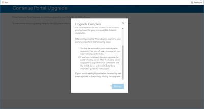

Hello - does anyone have any idea on the time for the 'Continue Portal Upgrade' step to complete at 10.9.1 on a Windows Server 2016 VM (8 core 32Gb)?  We don't have any customizations or that large of a content directory (around 40Gb worth of Items)
For us, at 10.9 this post upgrade step took 4 hours.  I'm now well into hour 5 watching a spinner gif 'Waiting . . .'
I feel like if this page had launched with my dns name and valid cert as opposed to machine name this wouldn't be taking so long-
Thanks

6 hours now. . .

Has anyone ever killed the post upgrade step?

I had to gamble and kill the post upgrade after 8 hours.  Something was hung somewhere.  As I mentioned, at 10.9 the post upgrade took 4 hours.  We have a distributed deployment (web server, portal, 2-machine host site, relational and tile cache datatores on Windows Server 2016 VM).
My guess is Living Atlas data hung it up but who knows.  Without any benchmarking anywhere its impossible to know.
