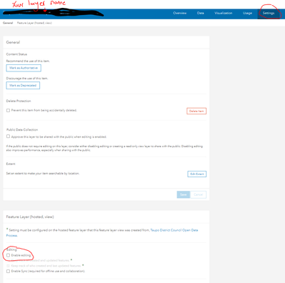

TaupoDistrict_Council
Within your feature layer settings on Portal you might want to check that Enable Editing has been ticked.
by Anonymous User
Not applicable
I appreciate the suggestion, but it isn't a hosted feature layer. The data I'm trying to edit has been published on our ArcGIS Server site, so the Portal item is just a wrapper around a REST endpoint from the server. I'm just confused that now I'm unable to access/edit that REST endpoint the same way I used to in ArcMap.
