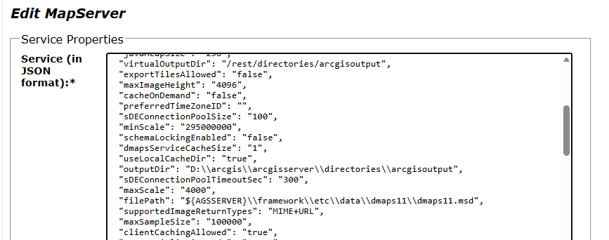

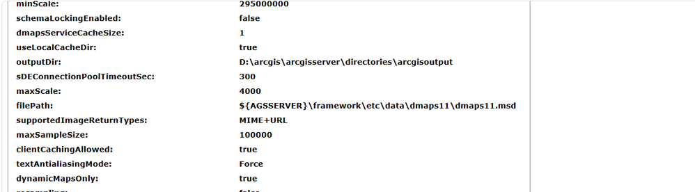

Ran into something similar with a system service as well. Cause was, iirc, an erroneous path in the the service properties.
Check in arcgis/admin -> services:
Verify whether that msd actually still exists and at that exact location on the server. You can also unzip it and check its contents.
Is something is amiss you can fix its properties with the edit function:
It's been a while, but recall someting about it incorrectly adjusting the entered path. Perhaps I fixed it by editing the json on the server itself or fixing the msd itself first.
