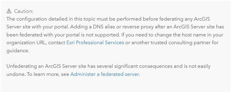

MarceloMarques
@JonSwoveland - I want to clarify that although you cannot change the webadaptor name as mentioned in my reply above, you can change the Portal Service URL if you follow the article below.
How To: Update the Service URLs of Portal Items in a Federated ArcGIS Enterprise Deploymen (esri.com...
| Marcelo Marques | Esri Principal Product Engineer | Cloud & Database Administrator | OCP - Oracle Database Certified Professional | "About: In 1992, I embarked on my journey with Esri Technology, and since 1997, I have been working with ArcSDE Geodatabases, right from its initial release. Over the past 33 years, my passion for Spatial Databases and GIS data has become a central part of my career.." | “ The mountains are calling and I must go.” – John Muir |

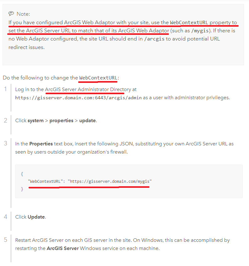

MarceloMarques
@JonSwoveland
A) For Portal
Article - How To: Update the Service URLs of Portal Items in a Federated ArcGIS Enterprise Deploymen...
An item’s URL is used to represent web-accessible items, such as map services, stored in ArcGIS Enterprise. For example, a map service can be embedded in ArcGIS Experience Builder using the map service’s URL. In some instances, such as moving services from one machine to another, the item’s URL needs to be updated to reflect the new machine’s hostname.
This article provides two methods used to update the service URLs of portal items in a federated ArcGIS Enterprise deployment.
FYI: Adding a WebContex-URL after Federation - Esri Community
B) For ArcGIS Server
Configure a reverse proxy server with ArcGIS Server—ArcGIS Server | Documentation for ArcGIS Enterpr...
C) For ArcGIS Data Store
Solved: Re: GIS Server URL for ArcGIS Datastore - Esri Community
ArcGIS Data Store utility reference—Portal for ArcGIS | Documentation for ArcGIS Enterprise - search for "URL"
