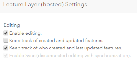

I need to disable 'Sync' on a Hosted Feature Service that contains 2 layers BUT the check box is grayed out

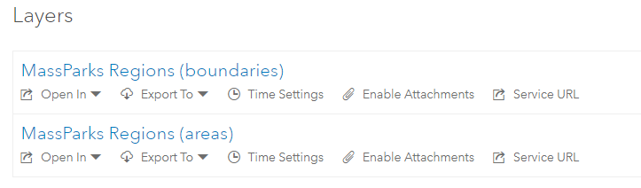

See screenshot below for the 2 layer feature service with the grayed out 'Sync' control:
ChandreyeeLahiri1
The solution to this comes from a wonderful ESRI solutions engineer, Krithica Kantharaj: "If you have a “View Layer” created from a feature layer and have sync enabled in the “view Layer”, then the parent layer’s sync will be disabled. Check if you have any views created from your hosted feature layer (and check the view layers sync settings)."
