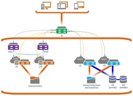

The architecture in Acceptance is a High Availability configuration.
All ArcGIS Enterprise software versions are 10.8.1 installed on Windows Server 2012 R2 machines.
The two ArcGIS Portal servers are configured using a Web Adaptor as the load balancer.
The two ArcGIS Server servers are configured using a physical load balancer of F5 type, no Web Adaptor configured for ArcGIS Server.
We also have an Integration environment configured using 4 servers.
In this configuration, ArcGIS Portal and ArcGIS Server are configured using a Web Adaptor.

Do we have to configure the physical F5 load balancer in Acceptance so that credentials are transmitted correctly from ArcGIS Portals to ArcGIS Servers ? Do we need WebAdaptors between the F5 load balancer and ArcGIS Servers ?
Do we have to embed credentials in a new printing web tool as described here : use the ImportCredentials function in ArcPy (arcgis.com) ?
