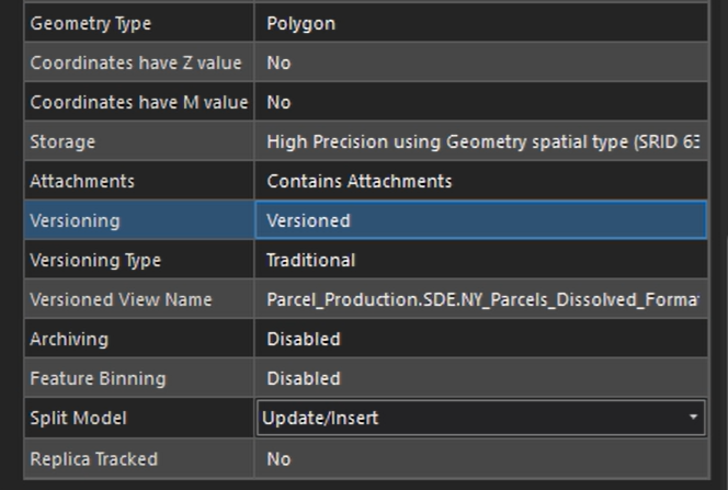

Hopefully I'm understanding the terminology correctly...we have parcel data stored on our SDE ("ArcGIS Server feature layer (feature service)") - NOT a hosted feature layer. These services are versioned.

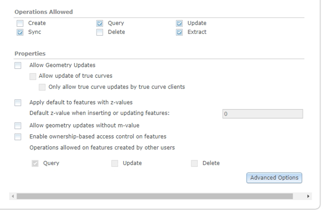

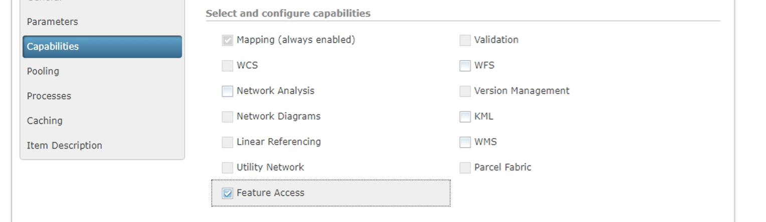

I can access these services in ArcGIS Server Manager and I confirmed the following settings:
Based on what I've read in the documentation, it was my understanding that if a service had sync enabled, then it could be used offline. However, when I add this layer to a web map and then go to the settings page for the web map there is no option to enable it for offline use.

    FYI: Your data is registered as traditional versioning, therefore read the part of documentation below, you need to work with replica versions in offline workflows.
    configure the data to meet offline requirements
    Scenario 3: Traditional versions are used to manage multiuser edits
    If your organization requires the use of traditional versions because you use a quality assurance version of the data, you can use the following offline workflows. Each workflow has specific data and publishing sections. Each workflow creates a replica version.
    As with all named versions, you must reconcile and post edits from all the replica versions generated in this scenario with their parent version. See Replica versions in offline workflows for more information.
    For examples of these workflows, see Offline maps and versioned data.

Si quieres trabajar sin tanto problema con la sincronización usa versionado en rama o no uses versionado y usa archivado habilitado. La versión tradicional da bastantes problemas para temas de sincronización no solo por que hay que conciliar al padre sino porque tienes que tener bastante cuidado por como creas la Base de datos y mirar bien lo que te puso @MarceloMarques porque cualquier pequeño paso que te saltes o algo que no hayas tenido en cuenta te va a dar problemas con el sincronizado siempre.
