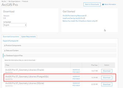

ArcGIS Pro has specific ST_GEOMETRY files, and the ones used above are for Desktop only.  Go to the ArcGIS Pro downloads page in MyEsri, and scroll down to the 'Database Support Files' section to download the PostgreSQL specific files.

YES-- this worked! THANKS. I just created  a parcel fabric to test it.
I got slightly misleading help from Esri Support yesterday, the tech told me to use any of the st_geometry.so files for the version of Postgresql I am running. I tried the ones I already had.
Does this mean the database is inaccessible from Desktop? Does not matter to me but still, awkward.
ReeseFacendini
Esri Alum
The database will be accessible from Desktop like normal.  The ST_GEOMETRY files needed to match the software being used to create the initial database.
