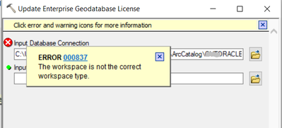

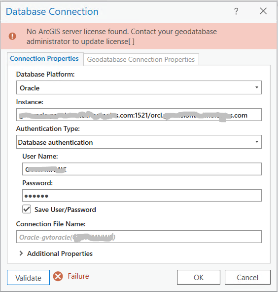

we are trying to connect to an Oracle database using the database connection dialog in ArcGIS Pro (enterprise) but we are getting the following error as shown in the attached snapshot even from ArcCatalog.
noting that this Oracle database was reachable from a previous standalone ArcGIS server and desktop installation before moving to ArcGIS Enterprise 11.2
kindly advise.

we are using Arcgispro 3.2.0 and oracle 19c. the connection was working fine with a standalone installation of ArcGIS desktop and server. but now it shows this warning which is new for us.
yes, it is an enterprise db but not created with SDE privileges.

Could this be due to an expired license?  No ArcGIS server license found...
Miguel
