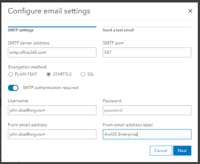

Yes, ArcGIS Enterprise Portal supports sending emails through Office 365. You will need to apply the settings below. When I have issues with O365, it's more often because STARTTLS is not selected as the encryption method. The attached image is a larger version of the one below.
Office 365 SMTP settings
  • Server name: smtp.office365.com.
  • Port: 587.
  • Encryption method: STARTTLS.
  • SMTP authentication: ticked.
  • Authentication: your password
