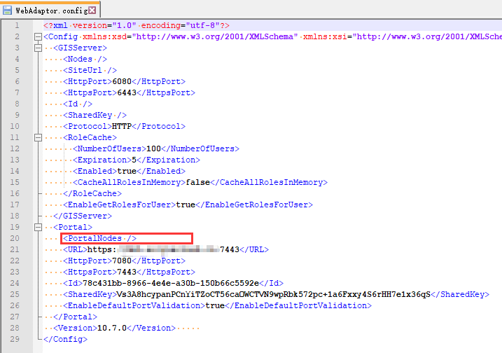

6.Config WebAdaptor(portal),  some doubt
Chrome cannot open https://***/portal/home
and  webadaptorofPortal.png in attach file shows I didn't config webadaptor(portal) successful !
And I try to find out why
Below is  what I am know right now!
Anyone know how to solve it ,thanks in advance!
"C:\inetpub\wwwroot\portal\WebAdaptor.config"
PortalNodes didn't get the domain host name
If I try to Set the right PortalNode,It will be changed (what you see in above)  when I try to visit https://***/portal/home

First, when configuring the Web Adaptor, reach the web adaptor registration page via the URL you want to use as the "public URL". For example, if my machine is wa.domain.com, reach the web adaptor registration page via https://wa.domain.com/portal. You may have multiple hostnames on the machine, but as long as you use the intended URL to reach the registration page, that will be written to Portal's config files.
Second, make sure that you use the correct hostname within the portal URL parameter. It should set the hostname within the portal nodes section in the webadaptor.config file.

I try to reach the web adaptor registration page via  https://myhostname/portal
and set the Public URL  with the same myhostname
but  the portal nodes section in the webadaptor.config file still empty!
