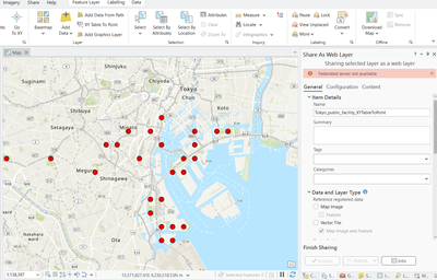

The error message "Federated server not available" occurs, and the Analyze and Publish button are grey-out (not clickable) when trying to share a map layer from ArcGIS Pro to the connecting ArcGIS Server. The operation steps: Right click the layer -> Sharing -> Share as Web Layer.

Hello @Wehara , the processes for publishing from Pro to a federated ArcGIS Enterprise and a stand-alone ArcGIS Server are quite different. It sounds like yours is working as expected.

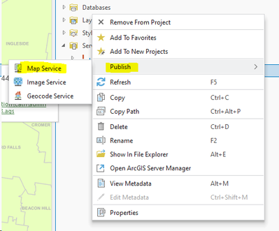

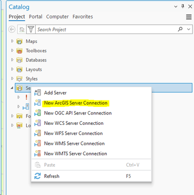

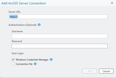

As your ArcGIS Server isn't federated with your server you will need to create a connection file to the ArcGIS Server and publish your services using that. For example:
View --> Catalog Pane
In the Catalog, find servers and right click on it and then create a New ArcGIS Server Connection.
Fill in your ArcGIS Server details.
Once the connection has been created. Right click on the server connection and publish your map service.
