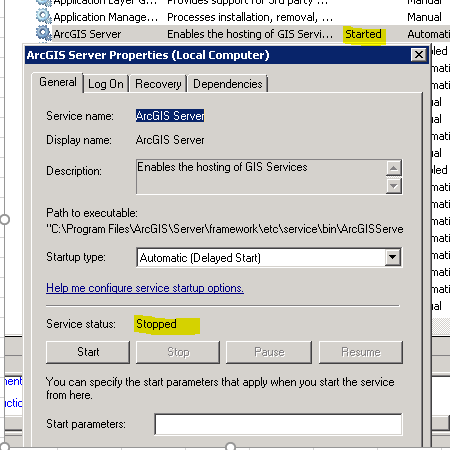

I checked the service and even if it showed "Started"  this is what i see if i double click the service (I guess it's wierd, but...)

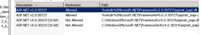

I have tried to enable the .ASP.NET 2.050727 as reported here 38370 - HTTP 404: "The page cannot be found" when trying to launch ArcGIS Server Manager (I know the version is not included in the the list but I wanted to give it a shot) but the asp.net is allowed.

You know, we already had the .NET frameworks installed on our box, but you may want to double check the system requirements page:
ArcGIS 10.3.1 for Server system requirements—Installation Guides (10.3 and 10.3.1) | ArcGIS for Serv...
It is calling for at least 3.5.1; looks like you have 4 installed, but as "not allowed" - maybe try flipping that to allowed and recycling IIS?
UPDATE: Just realized that 3.5.1 is only needed for for the ".NET Extension Support feature"

RandallWilliams
I'm willing to be that if the services dialog is refreshed, the ArcGIS Service will be listed as 'stopped'. Services attempting to start and then immediately stopping indicates a permission issue - the ArcGIS Service account doesn't have rights to C:\program files\arcgis\server.
I'd run the 'Configure ArcGIS Server Account' tool as an administrator. This tool will provide the required access for the ArcGIS Service account.
