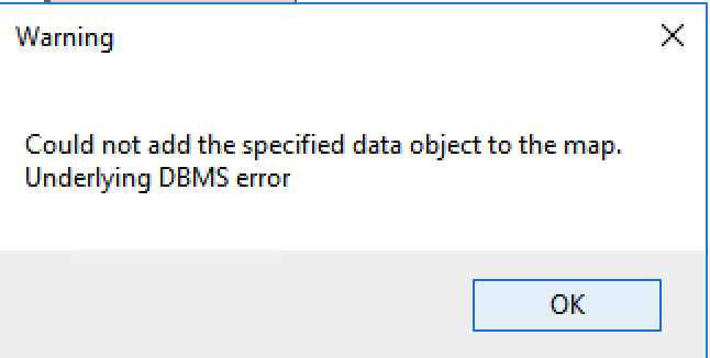

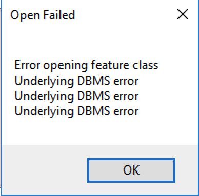

Using SQL Server, I created a view in Database A by joining another view in database B on the same server. The process is successful in SQL Server Management Studio and the view looks all good.
But when I added this view to ArcMap(10.6.1), it occurred errors as shown below. The errors are too generic so I didn't know how to fix this issue.
From my understanding, ArcGIS allows user to create a view from two databases.
Though I also tired to create a view in ArcCatalog by right clicking the database and selecting New--View, it threw the same error messages to me.
UPDATE
The spatial column of the view is from database A, so I enabled Geodatabase for database A, but didn't enable Geodatabase for B, could this be the issue?
ZacWang
Let me answer the question myself.
The cause of this issue is that the database account I used doesn't have access to one of the databases.
So the solution is also straightforward. Use a suitable account.
Basically, ArcGIS should provide a more useful error message.
