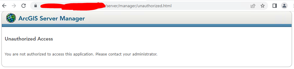

I've just installed ArcGIS Enterprise using the Enterprise Builder - so this comes with ArcGIS Server, Portal, two webadaptors (server and portal), and Datastore.
I can access Portal just fine using the credentials that I was asked for during the install, however I cannot access the Server Manager. I keep getting an "Unauthorized access" message, as below:
Anyone got any ideas? This is the last part in this (very long) saga I feel, as I just need to get into Server Manager and register my data source.
ReeseFacendini
Esri Alum
If Enterprise is version 10.8.X or later, Data Store sources can be added through the Portal for ArcGIS UI as well as Server Manager.
Add /New Item -> Data Store, and follow the prompts to add a folder, database, or Cloud Store connection.
MichaelBell
That's worked pretty well, thanks. And somehow I can access it on my server machine too!
