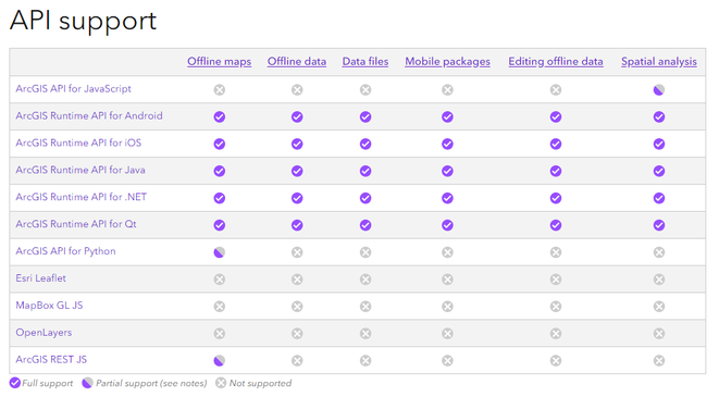

offline capabilities for ESRI JS APIs are limited, the ArcGIS JS API won't support that out of the box. I would suggest that to go through the "Build Offline Applications" guide from ESRI Developer website, which details the possible options provided by ESRI APIs:
https://developers.arcgis.com/documentation/mapping-apis-and-services/offline/
Also, I am adding here offline capabilities matrix for different ESRI APIs
