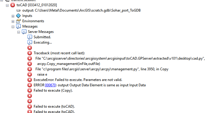

when i run the script from ArcMap it successfully creates a dataset with the features inside the scratch geodatabase, on the published service i get the same error as Nagorneac Constantin‌ when i run from web appbuilder however when i check the job output in the server directories i find that the scratch geodatabase has been created and features inside as well.
this tool here does the same function i or " we " need but i have no clue how to do the same since i have no knowledge in python, i also used you methodology using model builder and it worked but couldn't get the file to be imported dynamically, the service always copied the used CAD file to the server and made it as a constant.
when i run the published service from Arcmap i get an error

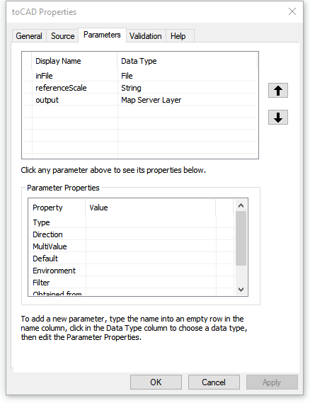

these are the parameters i add to the script
this is the current code in the script
