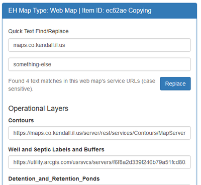

You want the ArcGIS Online Assistant, it was made for this sort of thing.
Click either "Update the URLs..." under "I want to...", then select an item from the list at the left. You'll be presented with a simple find/replace dialog.
Edit: you could also do this with the Python API, but that probably depends on how many maps/apps you need to re-point to the new source. Once your find/replace text is written, you'd only need to click "Replace" once per map/app, so up to a point, I think it would be faster than figuring out the code.
