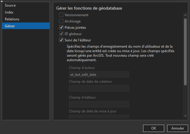

I encounter a bug when I use arcpy.management.EnableEditorTracking on ArcGIS Enterprise 10.9.1 (not ArcGIS Pro)
The method seems to not support the None value for the fields parameters:
import arcpy, os
FC = os.path.join(r"\\server", "my_database.sde", "my_feature_class")
arcpy.management.EnableEditorTracking(
    in_dataset = FC,
    creator_field = None,
    creation_date_field = None,
    last_editor_field = None,
    last_edit_date_field = "et_last_edit_date",
    add_fields = "ADD_FIELDS",
    record_dates_in = "UTC"
As we can see in the screenshot, the et_last_edit_date field is applied to the creator field (Champ d'auteur in french) not the last edit date field as it is specified in the code above.

Thank you for taking the time with this. Unfortunately, what you suggest does not solve the problem with the arcpy.management.EnableEditorTracking
The script just not works when I remove the unused parameters.
    in_dataset = FC,
arcgisscripting.ExecuteError: ERROR 001215: Enable editor tracking skipped for field: et_last_edit_date.
I have tried all possibles parameters combinations and there is no way to make the function enable tracking editor only for the last modified date field.
