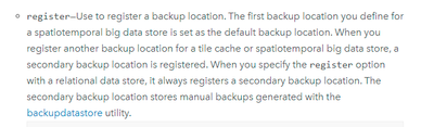

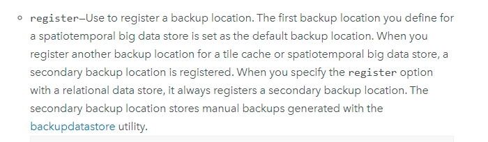

As per the ESRI documentation, we can register a secondary backup location for tile cache and spatiotemporal datastores and set that secondary location as the default location for the backups.
And in the case of relational datastore, we register a secondary backup location but we can't set it as a default backup location, We can take only manual backups on the secondary backup location.
