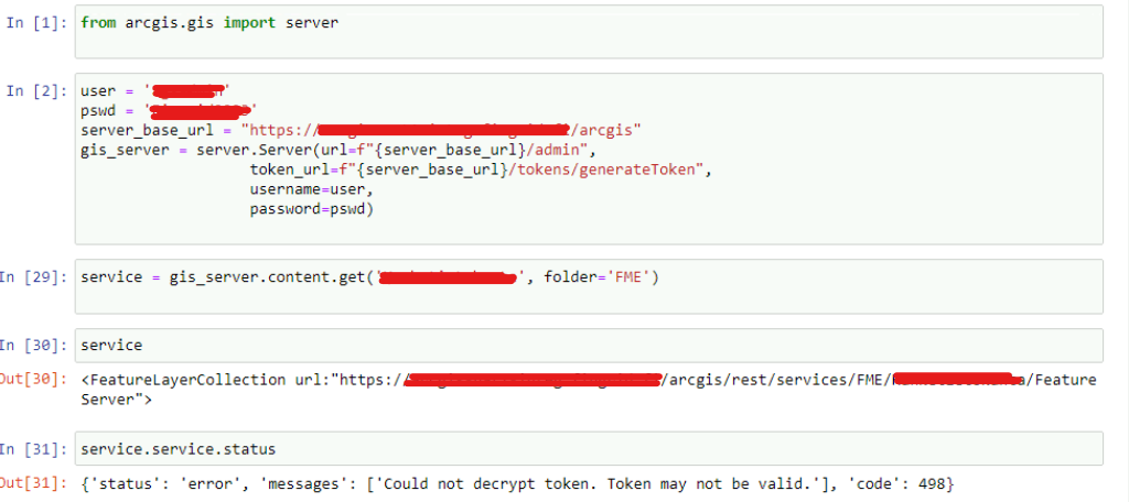

We are hitting the exact same error with ArcGIS Server 11.3(Standalone).
https://github.com/Esri/arcgis-python-api/issues/752
Is this something re-triggered, or is not yet fixed?
The error is only reproducible for the services in folders, for services in root, the issue is not reproducible.

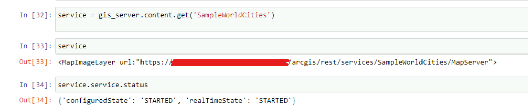

This same works if using the services in root:
