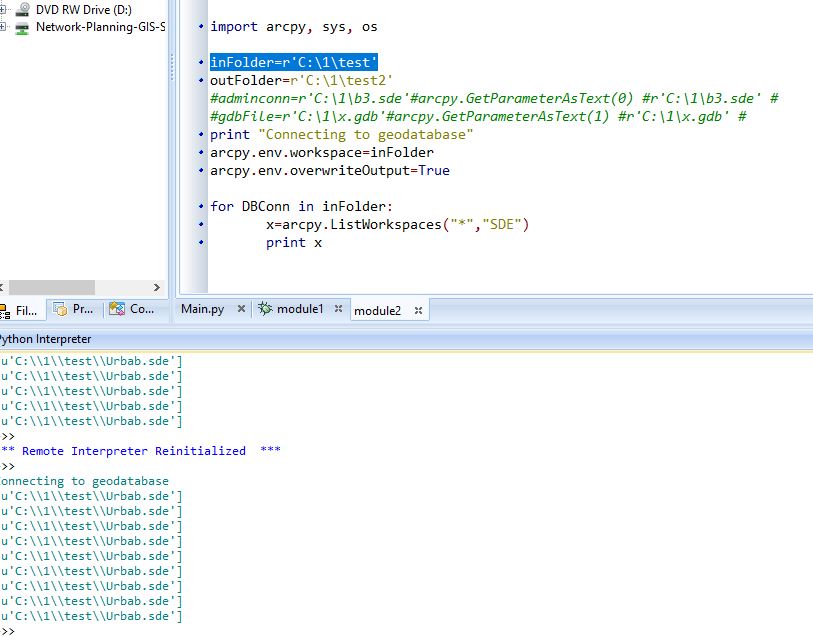

I am trying to get a list of database connections stored in the folder, the script runs successfully but it gives wrong results!
For example,  "inFolder=r'C:\1\test'"  has only one database connection which is u'C:\\1\\test\\Urbab.sde', but when I run the script it displays it 9 times every time! I tried to run the script from the python window in the ArcMap and I also used PyScripter and both of them gives the same result.
import arcpy, sys, os
outFolder=r'C:\1\test2'
print "Connecting to geodatabase"
arcpy.env.workspace=inFolder
arcpy.env.overwriteOutput=True
for DBConn in inFolder:
       x=arcpy.ListWorkspaces("*","SDE")
       print x

The reason it is displaying 9 times, it is most likely because your
loops thru each character of the inFolder path.
That is, if you replace the print X with print DBConn you would get (this is why you are printing the same X 9 times)
C
t
e
s
t
So, you will want to populate "x" prior to the loop, then do something like
for DBConn in x:
  print DBConn

AhmadSALEH1
Thanks Rebecca, This was helpful.
Here below how the script looks now.
Workspace=arcpy.ListWorkspaces("*","SDE")
for DBConn in Workspace:
       print DBConn
