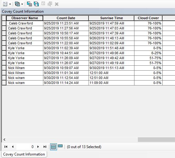

This is the table with collected, existing data. It has 13 records:

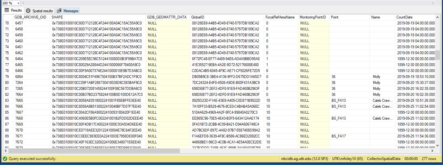

This is what the same feature class looks like on the backend, in SQL management studio. Note, it returns 277 rows. I had a bunch of people testing the application in the field, so they created a bunch of dummy data and then deleted it via the Collector application. Yet is still shows in the backend table?:

I would think this is by design. It keeps all the records in the same table for querying in the future. The ArcGIS client only shows the "valid/active" data in the view. You can query previous edits/records based on time/dates.
https://pro.arcgis.com/en/pro-app/help/data/geodatabases/overview/the-archive-process.htm
I will only create a separate table when you disable archiving: https://pro.arcgis.com/en/pro-app/help/data/geodatabases/overview/disabling-archiving.htm

Thanks. Kind of sucks if you will never care about archived records. Maybe I can make a view in SQL Mgmt studio that only shows active records that updates everyday...
