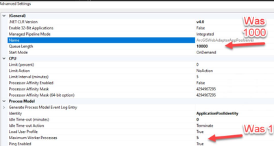

We upgraded to .NET 7.0 SDK (v7.0.305). In addition, we followed the AppPool approach by @SavageTrimble. Initially, I only did this for the AppPool 4.0 which didn't help, but now that it's configured on the enterpriseAppPool on both server and portal machines it seems to be holding up. Fingers crossed.

It's web adaptor related. When our data freezes, I notice the ArcGIS Server and admin page (using web adaptor name) are hung up and do not load. However, our actual ArcGIS Server service and ArcSOCs are up and running just fine. We've been stable since I fully adjusted both of the AppPools on server and portal vm's. We also upgraded our .net core software (not sure if that was an issue to begin).

It didn't work for us either, i will try to implement the @SavageTrimble  workaround.

In speaking with the product team, we don't believe the workaround is applicable to the ArcGIS Web Adaptor (IIS) 11.1 because the 11.1 version utilizes .NET 6 (whereas earlier versions were utilizing .NET 4). Do you have an existing case number with Support I can reference? If not, please get in touch with Support so we can look into this further.

Hi @KaitlynStevens .
We implemented the @LukeSavage  workaround  this Friday late morning, after verifying that the patch did not solve the problem, and from that moment on no more problems occurred....."so far".
Let's wait and see how this week goes, if the problem of ArcGIS Server 11.1 via Web Adaptor IIS 11.1 becoming unresponsive for a few seconds, or even minutes, does not reappear again.

As an update, it has been a week since we implemented the workaround and everything is still working and no more problems have occurred. It should be noted that the problems occurred even after the patch was installed.
