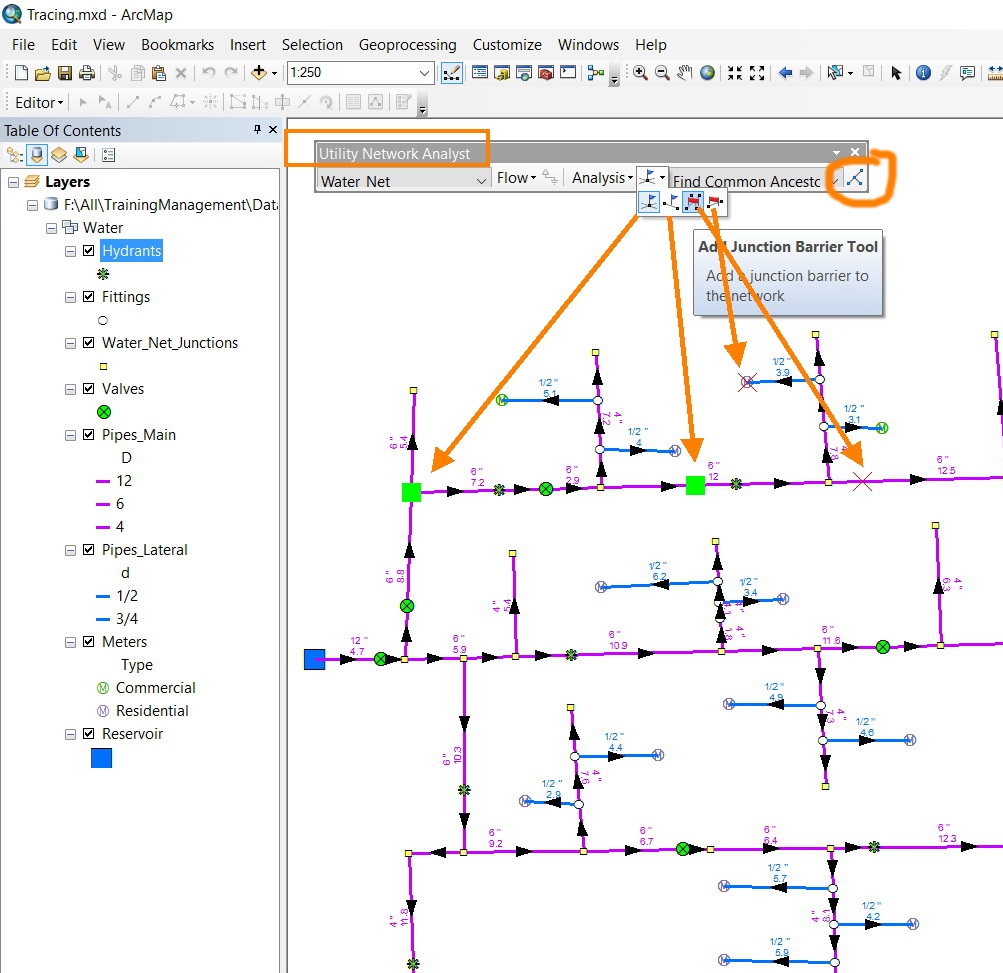

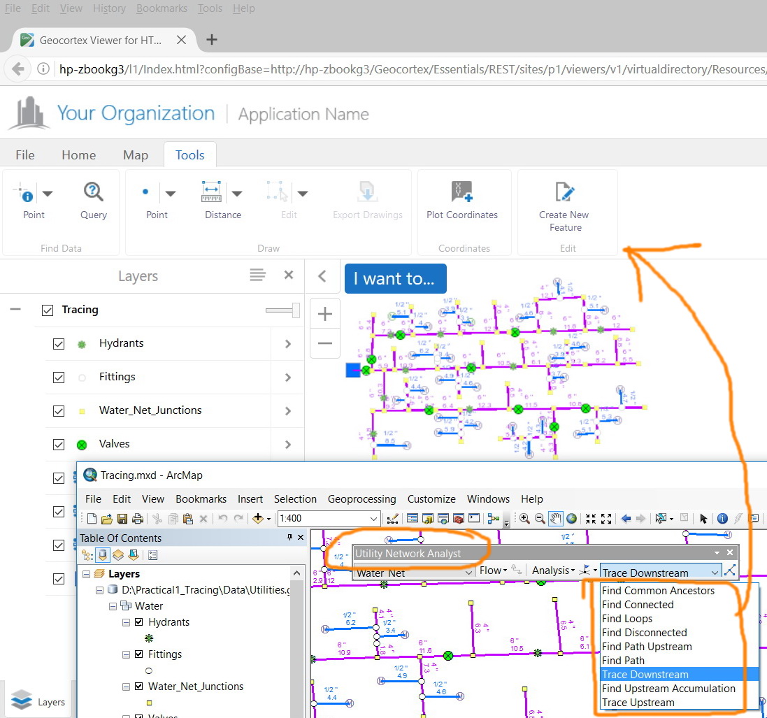

JamalNUMAN
Legendary Contributor
The first challenge here is how to publish the whole functionalities of “utility network analyst” before going to enjoy also editing with full environment as in the desktop. For example, how to solve for all tracing options in the web?
Jamal Numan
