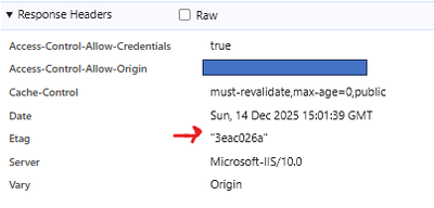

What I noticed is that if you query your ArcGIS Server VM individually:
https://gisVM01.company.com:6443/arcgis/rest/services/General/Data/MapServer/86?f=json&token=Foo
https://gisVM02.company.com:6443/arcgis/rest/services/General/Data/MapServer/86?f=json&token=Foo
and compare the responses, they are identical (to notepad at least) but they both have a different "Etag" header.
As a consequence, cache cannot be leverage.
It looks like ArcGIS Server machine is creating the Etag header by taking into account specific properties to the VM. As I am hitting my servers in a round robin way behind a load balancer, I always have 50% layers responses with 304 Not modified and 200.

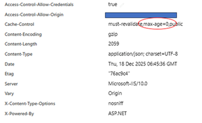

> The problem is that I configured "cacheControlMaxAge" property on this service and for a reason unknown to me, it does not apply to request in the form of:
https://gis.company.com/arcgis/rest/services/General/Data/MapServer/86?f=json&token=Foo
It does work on 'query' request:
returns:
Good, this request will be cached for 30 minutes.
But the request:
even if "cacheControlMaxAge" is configured always returns "max-age=0" and as the 'etag' headers changes depending on machine replying, this is never cached nor getting a 302:
Any reason why  @ArchitSrivastava ?
