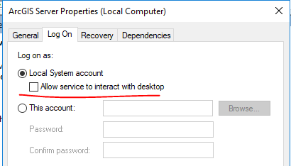

MarinProdan
Hi, i had the same problem and this was solved by change in ArcGIS Server Properties to Log on as: Local System account
RandallWilliams
I'd contact support services and look for a better option. Running an application server as the local system account is highly unadvised from a security perspective.
