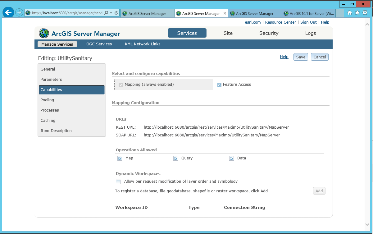

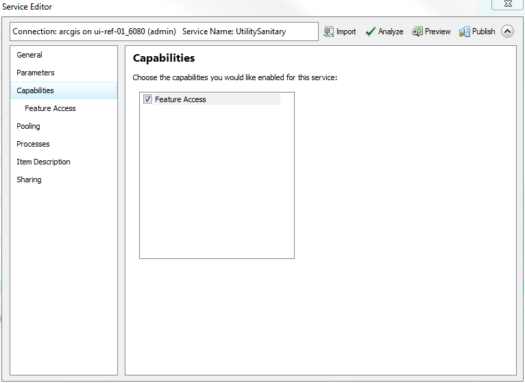

When I try to publish a map service, the only option that is provide is for a Feature Service.
If I publish the service anyway, I start seeing the following errors in the log.
<Msg time='2014-11-20T21:51:50,849' type='WARNING' code='10823' target='Maximo/UtilitySanitary.MapServer' methodName='MapServer.Construct' machine='UI-REF-01' process='6032' thread='7352'  >IsCached property not found.</Msg>
<Msg time='2014-11-20T21:51:50,857' type='WARNING' code='10824' target='Maximo/UtilitySanitary.MapServer' methodName='MapServer.Construct' machine='UI-REF-01' process='6032' thread='7352'  >CacheOnDemand property not found.</Msg>
<Msg time='2014-11-20T21:51:50,857' type='WARNING' code='10825' target='Maximo/UtilitySanitary.MapServer' methodName='MapServer.Construct' machine='UI-REF-01' process='6032' thread='7352'  >IgnoreCache property not found.</Msg>
<Msg time='2014-11-20T21:51:50,858' type='WARNING' code='10826' target='Maximo/UtilitySanitary.MapServer' methodName='MapServer.Construct' machine='UI-REF-01' process='6032' thread='7352'  >ClientCachingAllowed property not found.</Msg>
If I look at the service in Server Manager, the mapping option is greyed out.
I'm running ArcGIS Server 10.1 SP1 on a Windows Server 2012 R2 Standard
Anyone see this before?

This means that you only have ArcGIS Server Basic (not Standard or Advanced) licensing.
