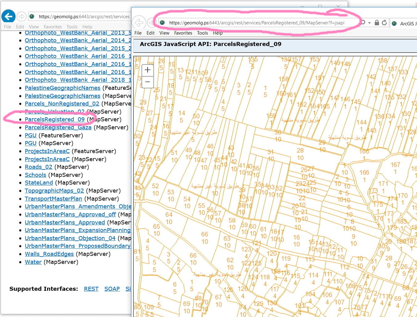

In our workplace, we have two heavy services, one for parcels of about 300,000 polygons and the other for Urban Master Plans of 50,000 polygons. The ArcGIS Server is really struggling in displaying these two services.

One more issue - from your screen shot it looks like you are not using scale depended renderer.
You should turn on labeling in smaller scale.
Make sure you do not have more then 2000-3000 polygons on screen at max. No reason to have more then  300 labels (you cannot see more anyway). Adjust your renderers
