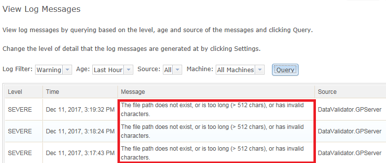

The AGS can no longer validate the registered databases connections it has contained and provided its services with for a long time thru the Manager. ArcCatalog can still connect to the database using the very same SDE connections it created to registered connections to the AGS. It can even create new ones just as well. It can also connect to the AGS as usual to access server properties.

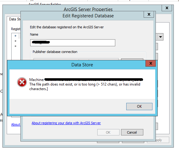

However, ArcCatalog cannot edit the registered database connections without running into the same issue. It cannot even replace the failing connections with the ones it can connect to the database with because, as it appears, AGS can no longer use them. To be thorough in my question, Desktop is also installed on the same web server, so the server has both 32bit and 64bit Oracle client software deployed, and the 64bit is shown first on the PATH values. Recall that it has worked as-is for awhile.
I've searched for "The file path does not exist or too long (<512 chars), or has invalid characters." and found little info with resolution that would solve this. Any ideas?
