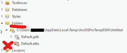

On our side, in the end we kept having this SMB error that we thought would be solved by removing the incorrect registered data store.
We found out using "process monitor" that the SMB error was coming from ArcSoc process when starting a new soc instance. We searched everywhere for this path on ArcGIS Manager and Admin interface: could not find any mention of it.
Then we checked the ArcGIS Project used for publishing and found out that this path was referenced as broken in the "Folders" list section as on the image below. We republished each service. SMB errors went away. No issue since then (10 days). To be followed.
Broken path in ArcGIS Pro folders projectBroken path in ArcGIS Pro folders project
Conclusions:
- I did not think that these paths matter in the ArcGIS Pro project for publishing
- The issue is still unclear to me: SMB error could occur without having necessarily a crash.
- Maybe because almost all our services (50) were published with this broken path, if several of these broken services start spinning up ArcSOC processes, it could lead to it ?!
