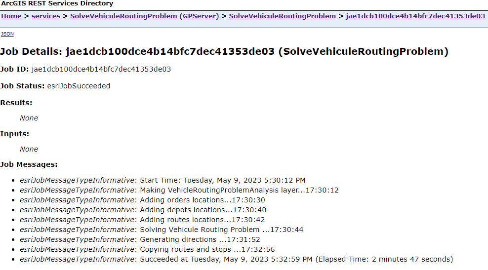

Since we upgraded from ArcGIS Enterprise 11.0 to  ArcGIS Enterprise 11.1, a simple geoprocessing service went from 3 min to run to 18 min.
With the same data and the following GP published:

On 11.0:
On 11.1:
5 times slower. Seems like a performance regression to me.
