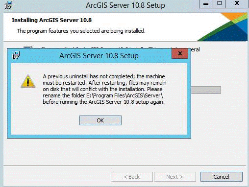

I am trying to upgrade stand-alone ArcGIS Server 10.6.1 to 10.8. When running the installer it correctly detects the previous install on E drive and prompts the user to rename the directory and rerun installer.
Rename Folder

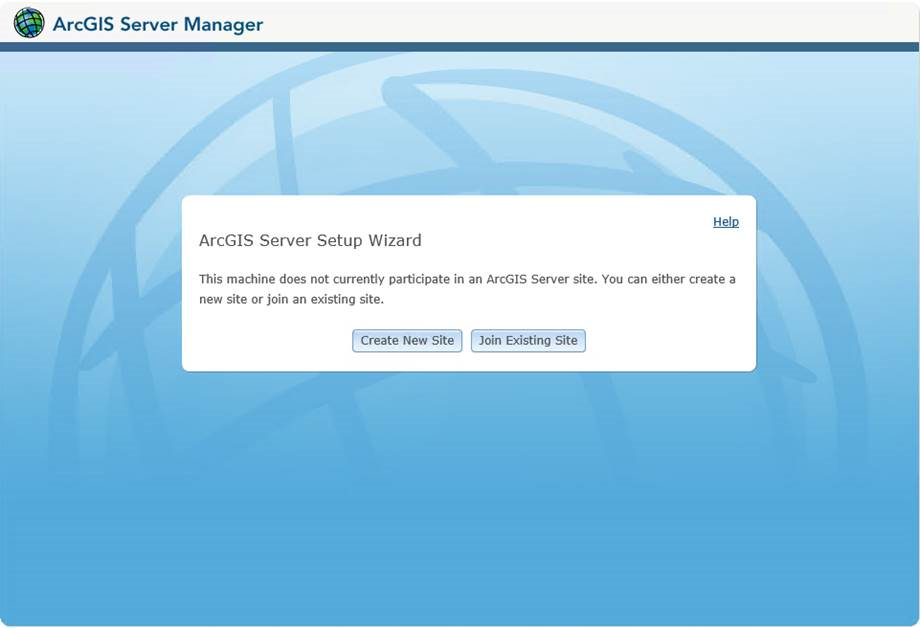

After rerun of the installer, it defaults the install files to C drive instead of E drive. Upgrade completes successfully but on loading the server manager we see a new install screen:
Server Manager
Any ideas as to why this might be occurring?

Thanks for your reply. Yes there was an existing ArcGIS Server site before we attempted the upgrade. The initial install configuration folders were located in E:\arcgisserver\config-store and this was a single-machine deployment.
I should add that we successfully did the same upgrade on our Dev server, however that server does not have a partitioned storage drive - only C.
Cheers,
Orlo
