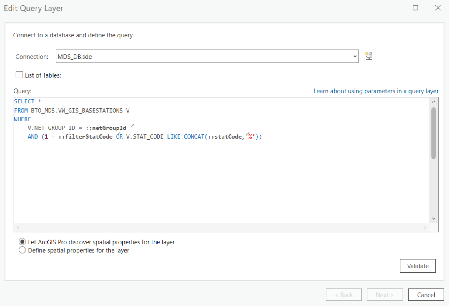

Arcgis Pro offers the possibility in the sql source to use query params and these params must have a default value. My question is: where should I define these parameters in the REST API request so that I can implement different filters in the sql query. I tried with "customParamaters" property as object, but it doesn't work.
Source definition:

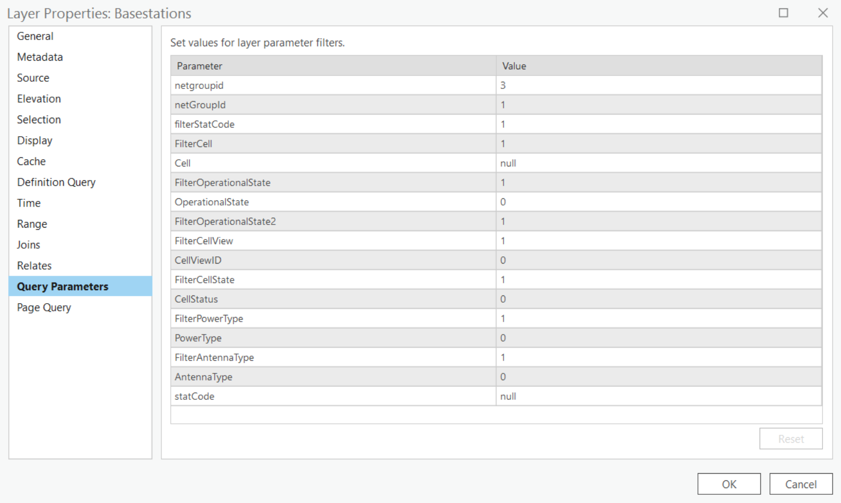

Query params:
2023-10-13 08_29_16-Layer Properties_ Basestations.png2023-10-13 08_29_16-Layer Properties_ Basestations.png

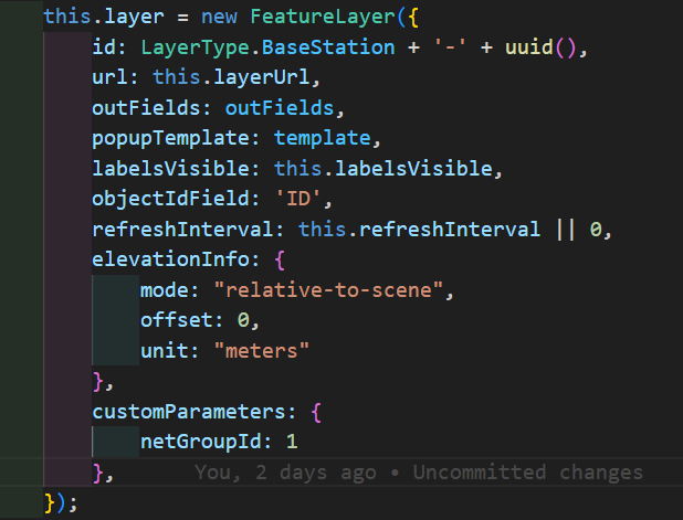

Javascript code:
2023-10-13 08_30_01-● basestation.ts - mds (Workspace) - Visual Studio Code.png2023-10-13 08_30_01-● basestation.ts - mds (Workspace) - Visual Studio Code.png

when you are constructing a feature layer in your js api code, you are right you need to use `customParameters` but you need to formulate it correctly. In your case, it should be something like
customParameters: {
  parameterValues: { netGroupId: 1 }
