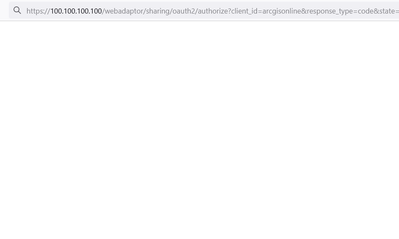

Update, I added my IP to the OAuth app info, and now I'm left at a blank "Sign In" page, nothing loads.
