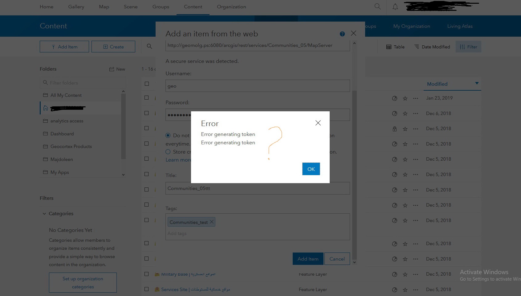

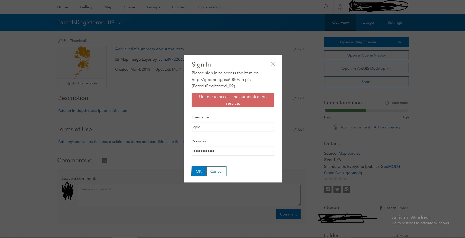

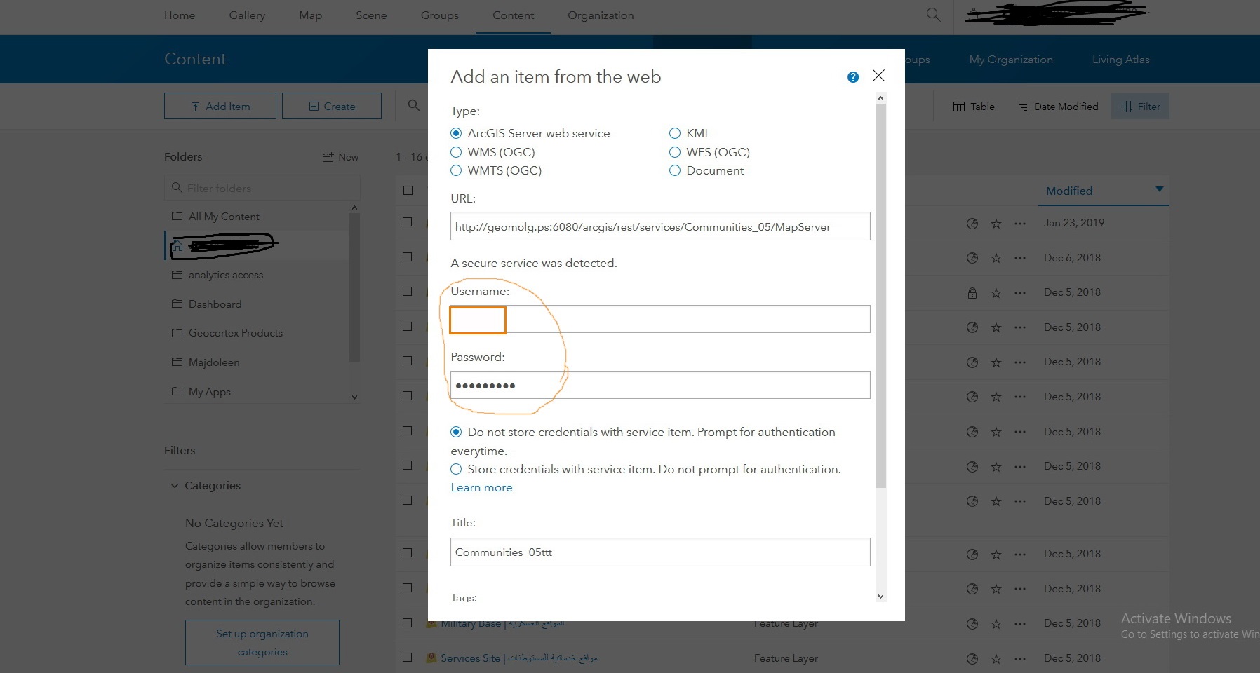

When the username and password have been entered, Error Generating Token has appeared as the following screenshots show.
What could be the issue?
