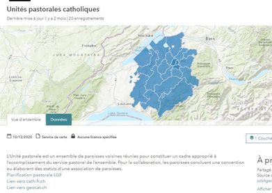

I wonder if there is any documentation on how to configure it in a way that symbology is being shown in the little mapviewer. I found out that if I share a Feature Layer it never shows symbology. However, if I share a Map Image Layer it sometimes does.
I have around 300 datasets that are all shared in the same way using a Python script. In half of the cases a symbology is shown, in the other cases not. Is there any documentation on how I need to configure my data before publishing it to ArcGIS Hub / Enterprise sites such that I can get a symbology?
Please see screenshots below for reference:
with symbology:
with symbologywith symbology
without symbology
without symbologywithout symbology

    Thank you for reaching out and I apologize for the time it has taken me to reply. There is an active enhancement for this issue (albeit for ArcGIS Online): ENH-000099492: Open Data does not support feature layer symbology and every symbology appears in default blue color.
This defect is currently in Product Plan, meaning that the product team will may address this issue in time. Even though it's logged for ArcGIS Online, it will make its way into ArcGIS Enterprise. Please log a case with Esri Technical Support to have your account added to the enhancement. This was you will know when the issue will be addressed.

Hello Ariel, The enhancement was closed as a known limit with the following closure text:
"Available workaround is to bring into web map to express cartography. While we have integrated some smart styling functionality into the feature layer visualization workflow, we have no plans of integrating future symbology representation at this time."
