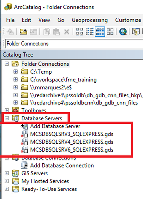

Note: ArcGIS Enterprise Workgroup allowed to create Geodatabases in SQL Express and manage then in ArcCatalog - "Add Database Server".
Workgroup geodatabases—ArcGIS Server | Documentation for ArcGIS Enterprise
workgroup geodatabase support ends when ArcGIS Desktop support ends.

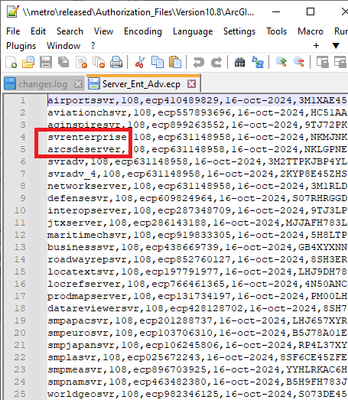

You can also update the ArcSDE Workgroup License in the SQL Express Geodatabase with the ArcGIS Server License File that includes the license for the ArcSDE Geodatabase.
The ArcSDE Geodatabase License is not sold separate, it is included in the ArcGIS Server License, so customers buy ArcGIS Server.
https://pro.arcgis.com/en/pro-app/latest/tool-reference/data-management/update-enterprise-geodatabas...
Example:
ArcGIS Server License File with ArcSDE Geodatabase License
srventerprise = ArcGIS Server
arcsdeserver = ArcSDE Geodatabase

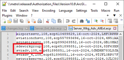

ArcGIS Server License File with Workgroup Geodatabase License
If you have questions about your license, then reach out to your Esri Account Manager.
