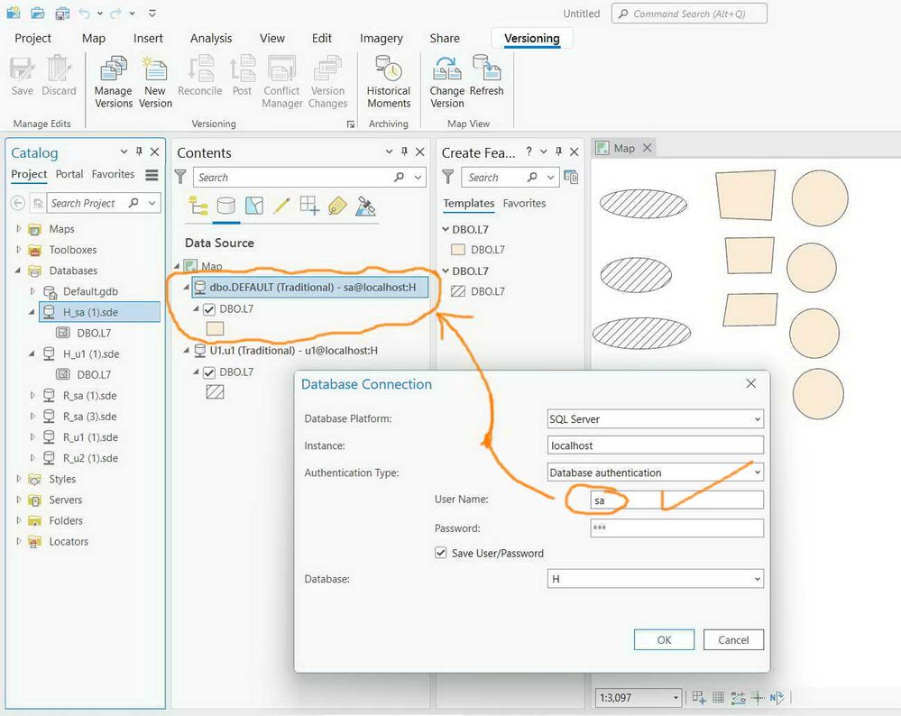

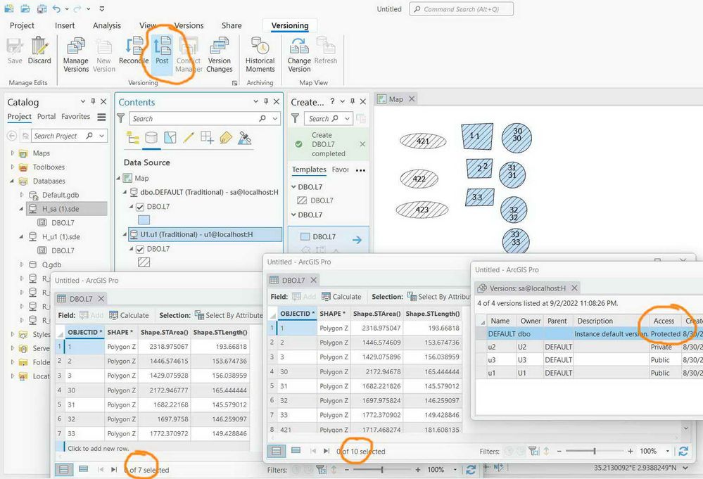

I couldn’t figure out how to “post” from child version to a “protected” parent version. I got a warning message as per the second screenshot

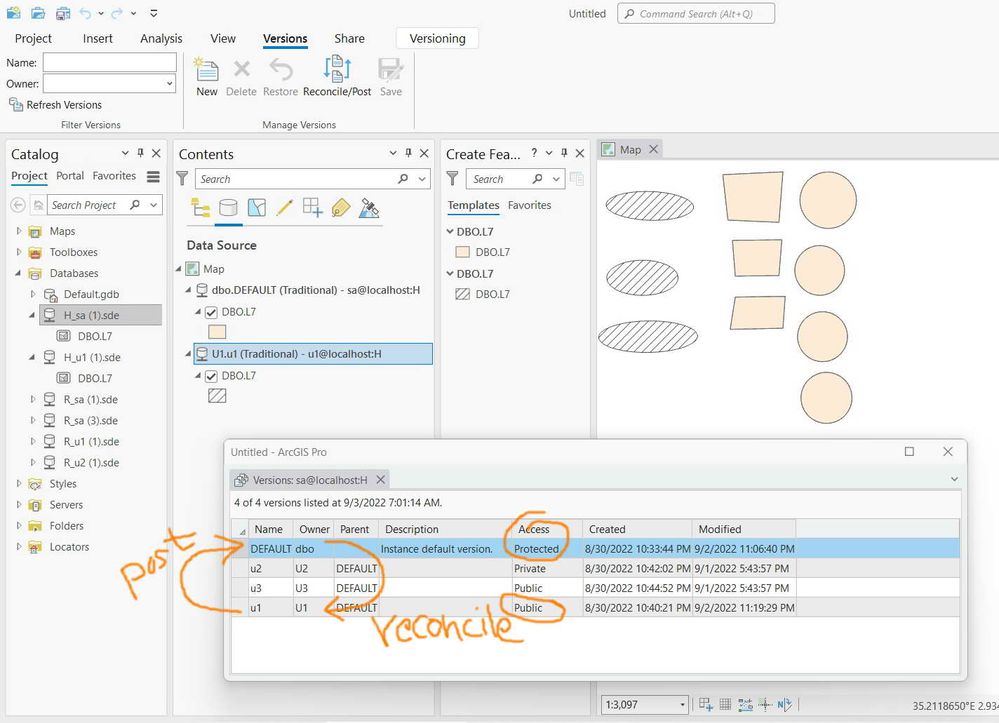

You're trying to post from the version that is edited, by the editor user within that version.  Because the default is 'protected' only the owner of that version, the data owner, can promote it.  So, you need to be logged in as SA and not U1.
U1 is a consumer of the version, not the owner.  The owner has protected their version from any consumers trying to post to it.

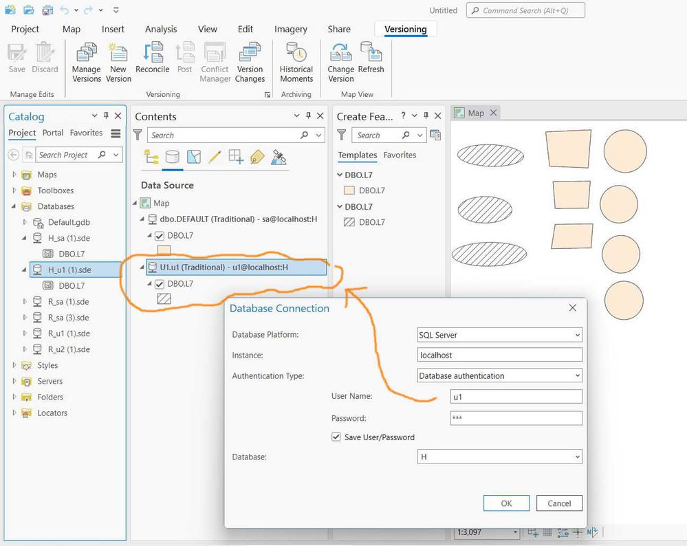

Both parent version and child version are logged in by their owners (sa and u1 respectively) as per the screenshots below. Then I’m still unable to perform the post (from the child to parent)
