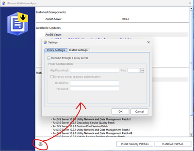

The patch notification tool has it's own proxy settings, i.e. it doens't share the OS or browser proxy information.  Can you check here:
to ensure you still have properties available.  The upgrade replaces this tool and may have wiped the settings in the process.

Hi Scott,
I have inserted again the proxy server and the credentials after the installation, but even like this the result is that error message.
