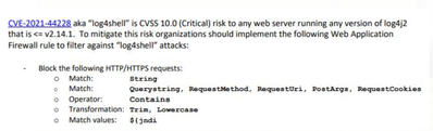

does the WAF applied to the ArcGIS enterprise hosted locally or just to azure . does applying . do the  attached settings below enough

blocking stings like ${jndi will mitigate this issue.
ChristophK
WAF filters like that can be easily circumvented with other nested filters, like lower/uppercase functions (lower:j, lower:n ...)
It won't allow me to post an example, but I hope the idea is clear.

Yes, but that doesn't change the fact that a WAF is a crucial part of any organization's defense in depth posture. No, a WAF won't eliminate ANY given risk, but security is about risk reduction with an eye toward risk elimination.
