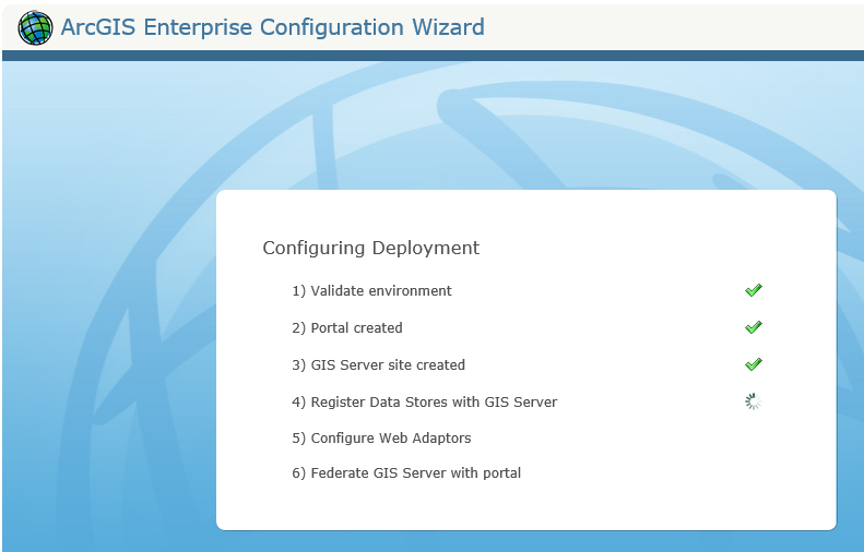

Hello all,
I've been doing a base installation using ArcGIS Enterprise Builder 10.7.1, but hit a point where the Configuration Wizard appears frozen on the "Register Data Stores with GIS Server" task (it has been like this for about 8 hours):
ArcGIS Enterprise Builder - Configuration Wizard frozen
The install is on a completely fresh Windows Server 2016 VM, and the only bit where I've made any change from default in the installation process are changing the install location to a non-system drive: D:\Program Files\ArcGIS
When asked for the content directory, the default was D:\arcgis. I checked and the installation had already created this folder with a small amount of items in there, but I still accepted that location assumed the default would be best.
The only bit of the installation which had gone non-standard was that I had to run the Software Authorization for ArcGIS Server wizard part way through. But it happily continued with the installation after that.
Does anybody have any ideas for what could be going wrong to cause this freezing up, or any pointers of which log file should be providing the best troubleshooting info? Or maybe what I should check for to see if the installation is actually doing something in the background?
Many thanks!
Ben

Thank you for your reply. It looks like the log files in that folder stop being used at an earlier point in the installation process.
However, when I logged into the machine to look at the log files, the configuration process had actually finished. But it appears to have taken nearly 24 hours for the "Register Data Stores with GIS Server" step to complete. As it completed just after midnight, I was thinking that maybe the cycling of an internal ArcGIS Server component had jump started the configuration?
As this installation time sounds out of the ordinary, I was wondering if there are any options to perform a health check on the installation?
Kind regards,
Ben

BenO_Connor
Great! I've run those steps and they are all showing the validation was successful for both the components. I'll run some publishing tasks to ensure that is all working correctly also.
Thanks Thomas!
