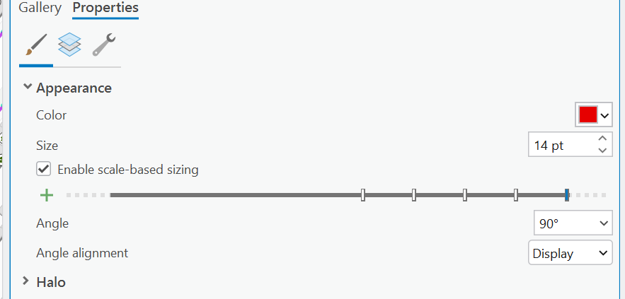

  3. Setting the symbology within ArcGIS Pro is also possible but it seems that it is not possible to scale symbology based on current scale. I've tried the following methods:

    2. Tried scale based sizing within the symbol
      Result: No orange symbology anymore but no difference when zooming in or out in the web map.

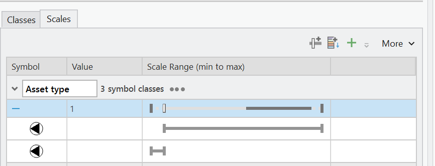

    3. Tried the scales option within the Unique Values screen
      Result: Same as method 2
