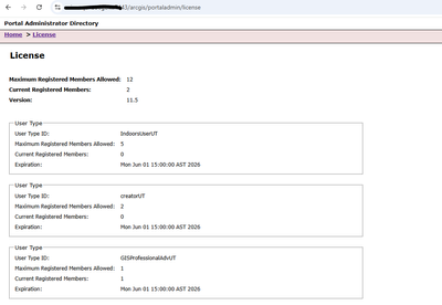

2.  Can you verify Portal is reading the ArcGIS Pro license by going to https://[machinename]:7443/arcgis/portaladmin > License
JodatAshgarKhan
Yes, Jack User is Professional Plus, and license are shown as current Registered Member, I think problem is somewhere here, "We have specified[machinename].local/portal as it was required and it was not accepting [machinename]/portal"
