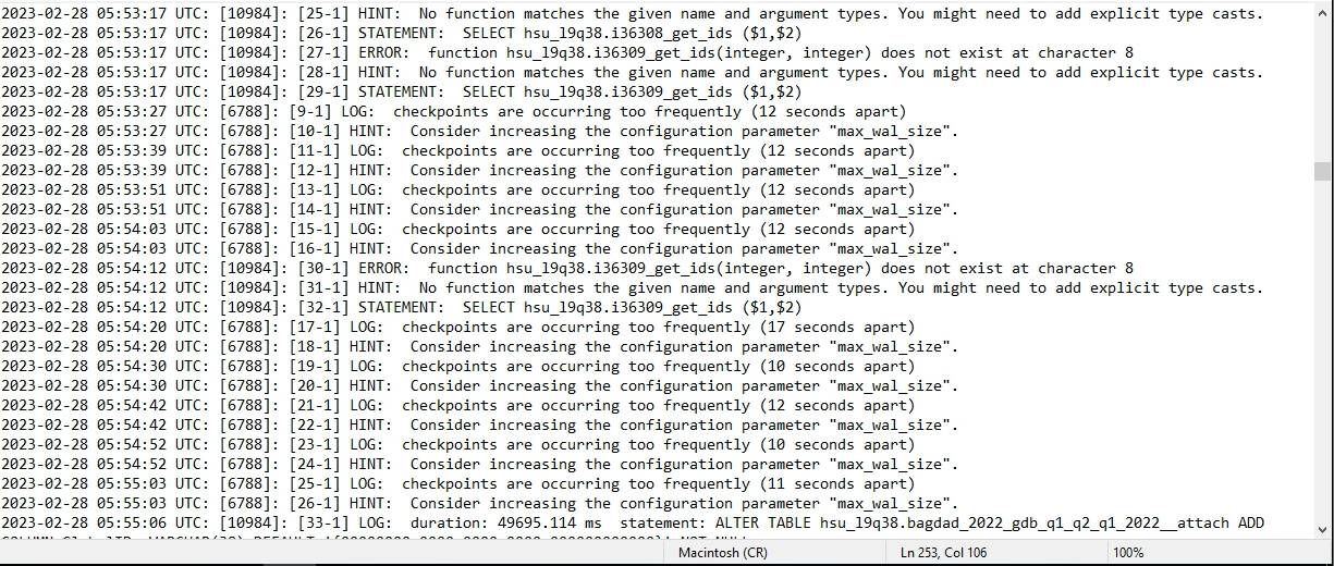

Upon further troubleshooting, we have found log messages in datastore database logs stating "Checkpoints are occurring too frequently" Hint: Consider increasing the configuration parameter 'max_wal_size'.  Attached are the datastore database-level log messages.

Can anyone help me out with what are these log messages about and how to overcome this in the future?
